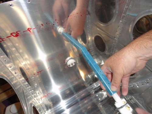

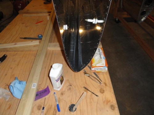

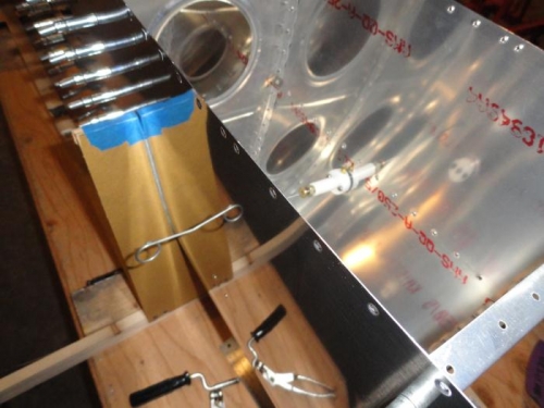

Brief Description:  Install AOA ports in right leading edge
After scuffing and cleaning the skin contact area, I mixed up a batch of ProSeal and plugged the corners of the oil cooler shroud (bet you weren't expecting that!) I then used the sealant on the AOA ports and screwed them to the skins. I then used a piece of angle to mark where the drain tube would intersect the bottom skin (see Image 2) and then transferred the location to the outside before drilling it #40 for the extension tool.
