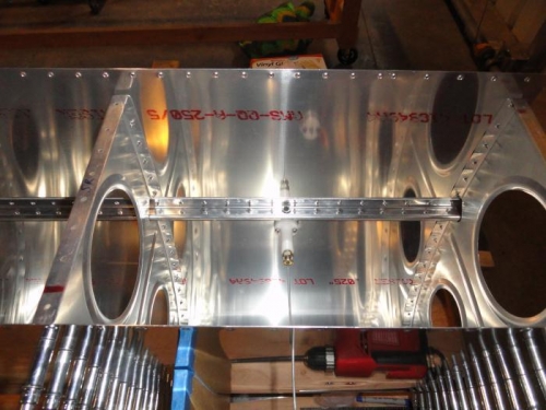

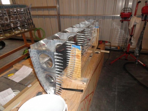

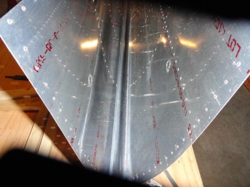

Brief Description:  Prepare right leading edge for riveting
Finished dimpling the skin and proceeded to dimple the ribs. Countersunk the nutplate rivet holes in the splice strip and then dimpled the rest of the strip, including the screw holes. Reassembled the skin and ribs. Since the J-stringer interfered with the routing of the AOA line (see other log entry this date), I put a hole in it to accomodate the line and a trimmed a snap bushing to fit. The stringer was clecoed in place temporarily to fit the bushing but will be removed while riveting the ribs.
