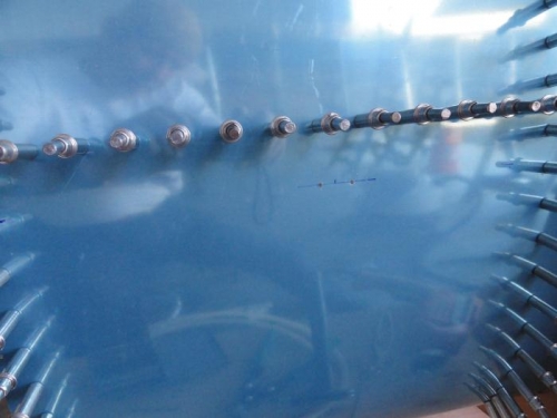

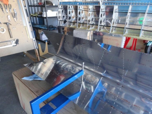

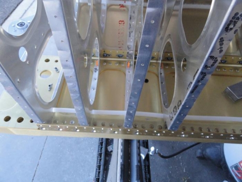

Planning for the AOA installation, I need to run the 1/8" tubes down the wing. Not liking how flexible they are, I installed 3/8" polyethelyne tubing. Then I marked on the leading edge skin where the AOA penetrations go and the associated screw holes. Then I started match drilling the skin, including the holes for the AOA screws. Then I disassembled everything and started dimpling the skins. I was interrupted by a tech consultation and a then by a visitor so I didn't quite finish the skin.
