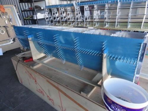

Brief Description:  Assemble right leading edge

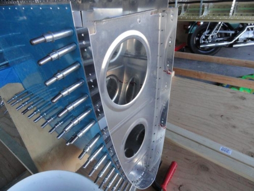

Assembled the right leading edge. Most of the parts had been prepared when the left side was done, so it wasn't necessary to flute the ribs again, for instance. Once I got the ribs in place, I put in the J-stiffener and then drilled it per the instructions. Short day because I got a late start due to other chores and because I need to stop and figure out the AOA tubing routing.
