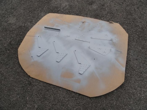

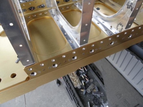

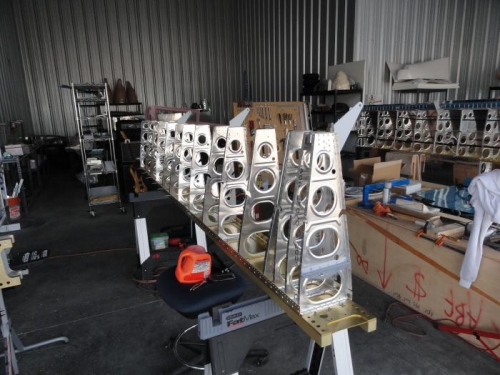

Brief Description:  Rivet ribs together and to rigth wing spar
I had fabricated the right wing ribs with the flap hing brackets back when I did the left wing, but I hadn't finished them. Now I attached them to the wing spar and match-drilled them, along with all the other ribs. I also fluted and drilled all ribs for the two wiring harnesses. Then I disassembled everything and deburred all the parts. I started with the parts that would have to be primed and put them out and primed them while I finished the rest of the parts. Then the rest of the day was spent riveting everything together.
