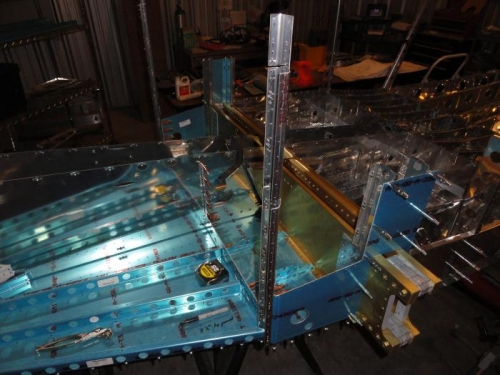

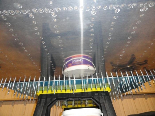

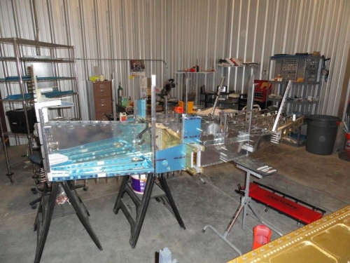

With some help from Phil Cobbin, I set the mid-fuselage on its belly and mated it with the forward section. After making sure the skins were aligned correctly, I joined the fore and aft center spar sections with the smaller bolts and the provided spacers. Then I clecoed the skins together. Next I added the side skins and the systems brackets.
