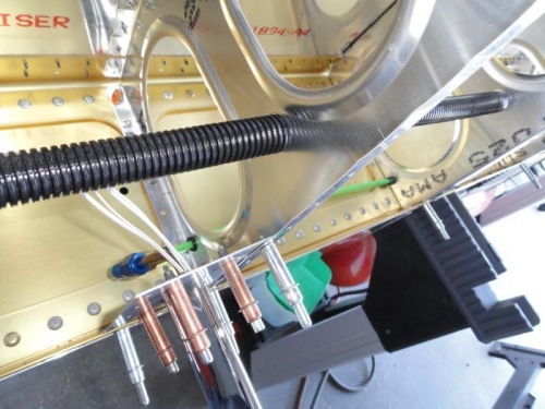

Well, first I finished the last parts for the fuel tank. I cut the Z-brackets apart and cleaned them up, along with the forward tank mount, and finished the edges on the fuel tank skin.

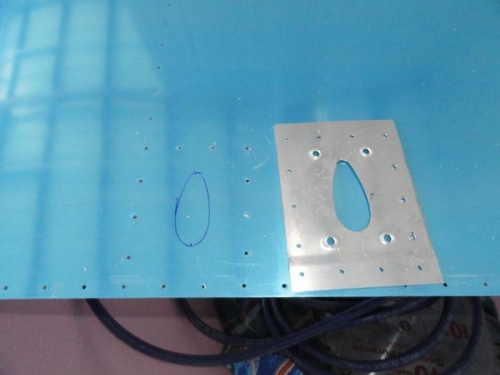

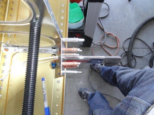

With that out of the way, I fit the mast mount to the spar and drilled the holes along the front edge of the mount. Next, I clecoed the mount to the bottom skin and drilled the holes along the rib. Finally, I marked the other two sides of the mount for rivets and then drilled it to the skin. Next, I clecoed the mount to the skeleton and set up the plumbing. I traded out the small fitting from SafeAir1 for a larger elbow fitting, and bent the tube from the mast and fit a B-nut to mate to the SafeAir1 tubing, which was then routed through the wing.
