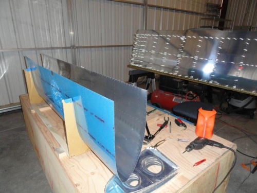

Brief Description:  Prepare and cleco left leading edge together

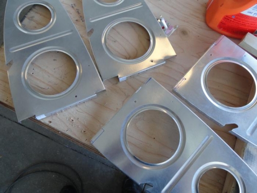

So I fluted the ribs and trimmed the two ribs per side per the plans. I also trimed the J-stiffeners and cut the splice strip from the left tank skin. I peeled the plastic from the inside of the skin and put it in the cradle. I started clecoing the outboard rib and was having difficulty with the nose clecos. Phil Cobbins dropped in and help; we ended up starting at the nose and working aft. After that it was just tedious doing all the ribs. When done, I added the J-stiffener and then called it a day.
