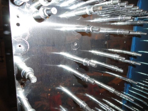

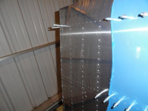

Manual Reference:  16-2.3
Brief Description:  Dimple and countersink wing walk area
Removed the plastic over the surface of the wing walk area and dimpled the rear screw hole, then countersunk the remaining screw holes. After that, I countersunk the skin over the wing walk doublers for AN426-AD3 rivets.
