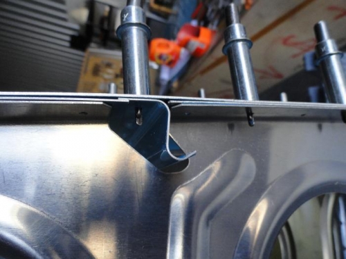

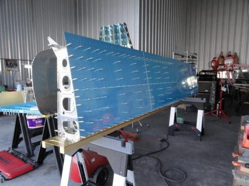

Brief Description:  Clecoed Left Top Wing Skins to structure
Laid the long and short wing stiffeners (the ones drilled and marked for the top left wing skin) into place in the wing skeleton. Then I began the process of clecoing the wing skins on. I started with the inboard wing and clecoed the forward row of rivets. Then I slid the wing walk doublers in place and clecoed them, and finally moved to the outboard skin.

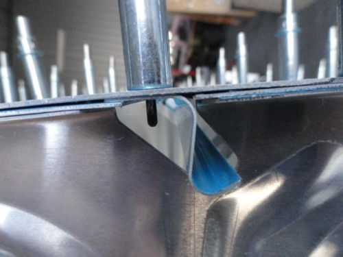

However, before I begin any drilling, I need to resolve an issue. The forward edge of the aft doubler sandwiches the J-stiffener between it and the skin, leaving a small gap. The other way I could do it would be sandwiching the doubler between the stiffener and skin, but the gap would still be there. My instinct is to trim the doubler to match the stiffener but I thould I'd consult the VAF forums before doing anything else.
