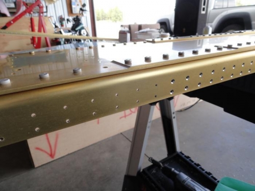

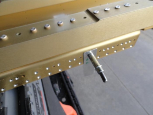

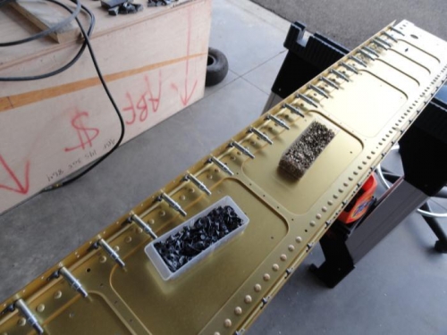

Brief Description:  Countersink the spar rivet holes and rivet nutplat
Countersunk all the nutplate rivet holes and then the remaining rivet holes a little deeper to take the skin dimples. Finished by riveting all the nutplates to the spar.
