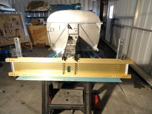

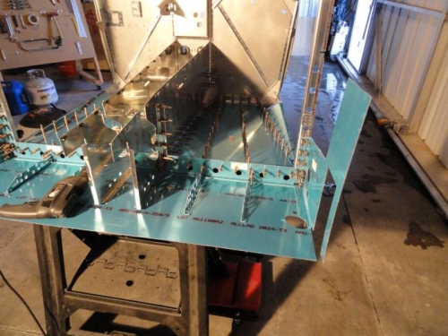

Brief Description:  Drill out the floors and add the fwd center sectio
Match drilled the floors with #30 bit. Removed the floors and drilled the screw and nutplate holes before setting them aside. I will wait until dimpling the floor ribs before dimpling the floors. Removed the systems bulkheads and the side skins and bulkheads, then attached the forward center sectino builkhead with clecos. Drilled the bolt holes and then the #30 holes. After deburrng, re-clecoed the bulkhead in place and then added the four AN3 bolts.
Lastly I laid out tentative locations for the antenna. I'm thinking the comm antennae left or right under the flap linkage. The transponder antenna to the inboard side of the right step mount under the baggage compartment and the marker beacon to the left of the tunnel under the forward seat.
