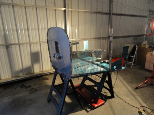

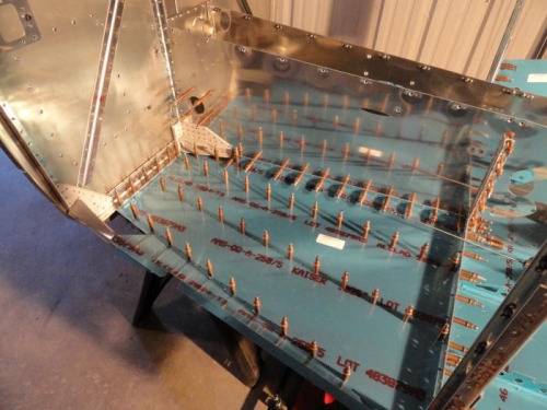

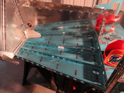

Date:  2-11-2011
Number of Hours:  2.30
Manual Reference:  28-6.2 to 28-7.2
Brief Description:  Forward bottom skin and floor assembly
Seperated the system brackets, deburred them, and clecoed them to the bottom skin. Attached bottom skin assembly to the firewall assembly. Clecoed the tunnel ribs and firewall flange to the skin and final-drilled everything. Marked the openings in the bottom skin on the F-1004K-L/R parts.
Clecoed and final-drilled the forward tabs in the floor ribs to the firewall. Then installed the left and right floors and clecoed them in place, pending final-drilling.
