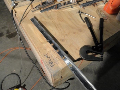

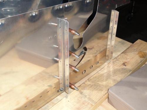

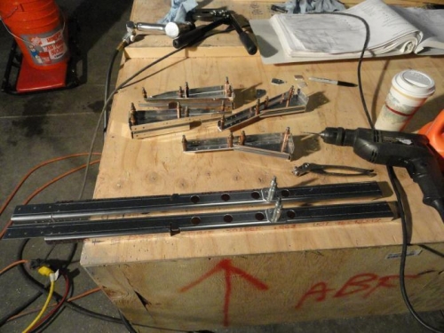

Brief Description:  Misc. Forward Spar bulkhead/seat parts
Seperated and attached the F1043C-L and R to the forward ribs and match-drilled them. Seperated the seat rail support anglest and assembled and match-drilled the inboard and outboard seat rail supports. Seperated the F1042 clips and spacers and cleaned them up on the scotch-brite wheel. Added the F1042 spacers to the F1042-L and R parts and match drilled. Final drilled all other holes (nutplate rivets and screw holes) as called out in the instructions. Countersunk all nutplate rivet holes. Deburred all edges and drilled holes. Began riveting with the F1042-L part; riveted the spacer and nutplates.
