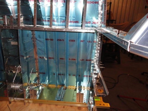

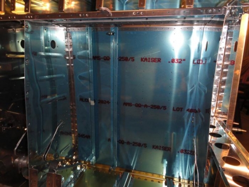

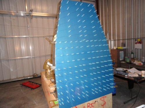

Brief Description:  Match drilled bottom skins to structure
Finished clecoing the bottom skins to the structure, then notice that the aft skin was reversed so I removed it and replaced it correctly. Next I clecoed the F-1016 L & R stiffeners in place. The bulk of the time was spent match-drilling the skins, starting aft and working forward.
