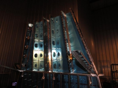

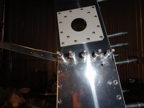

Brief Description:  Deburr and rivet baggage bulkhead and floor ribs
Disassembled all the ribs, bulkhead, and step weldments and then deburred everything. Dimpled the holes as directed. Riveted the baggage bulkhead to the rear seat ribs. Riveted the baggage floor ribs to the bulkhead. Riveted the weldments to the outer floor ribs and the floor ribs, together with the outer seat ribs, to the bulkhead with two keeper rivets each. Began clecoing the floor skins to the structure.
Rivet count: 108 Total: 5303
