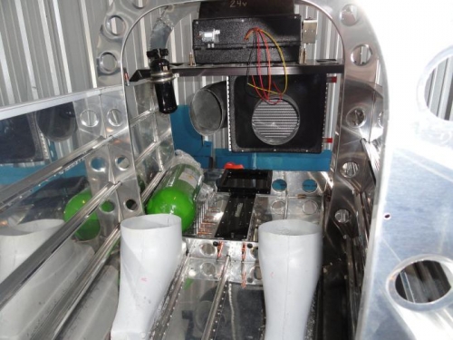

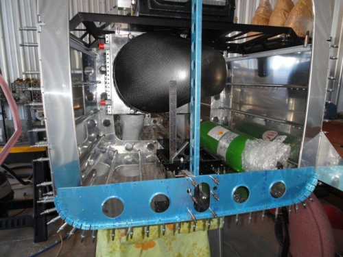

Brief Description:  More systems installation planning and install
Dimpled and clecoed the right side stringers and skin. With the skin on, clecoed in the forward bulkhead. This stiffened the longerons enough that I could locate the A/C mount and the condensor and evaporator assemblies. This showed me that my concerns about mounting the oxygen tank were moot; it would have to go on the left for ease of servicing. This will probably interfere with the AHRS mount (on order), but I will adapt. Finished fabricating the oxygen bottle mount and the bellcrank parts so they can be finished and assembled. Removed the battery mount and bellcrank ribs and riveted the nutplates to the bellcrank ribs before clecoing them back into the tailcone.
