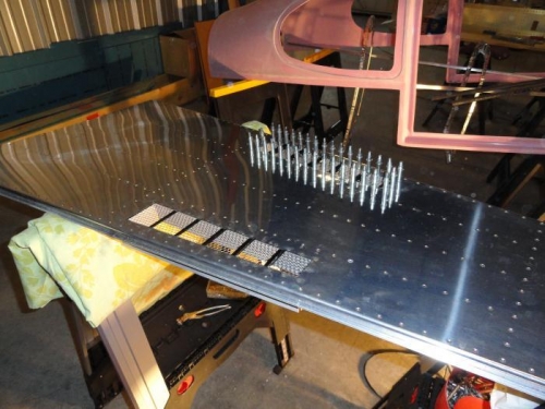

Brief Description:  Riveting wing spar aft bulkhead, tail cone

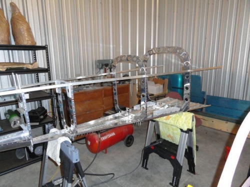

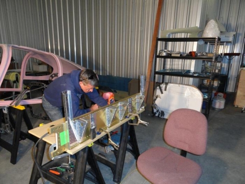

Jack Keegan (who built a beautiful Lancair Propjet with minimal assistance from me) assisted me as I riveted the wing spar aft bulkhead. Actually, I bucked the seat rails while he drove so that he got some riveting practice and because they were driven from the front side due to the flanges interfering with the gun. After that, the louvers for the air conditioning in the tail had set long enough (the ProSeal was slightly tacky still) and so we riveted them to the bottom skin and then replace the aft bulkheads and stringers in preparation for riveting.
