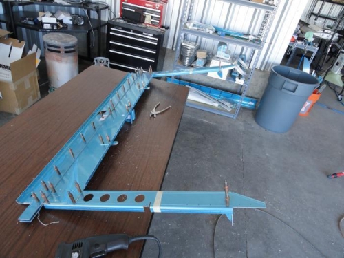

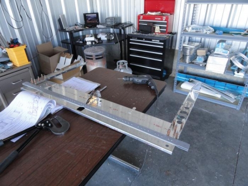

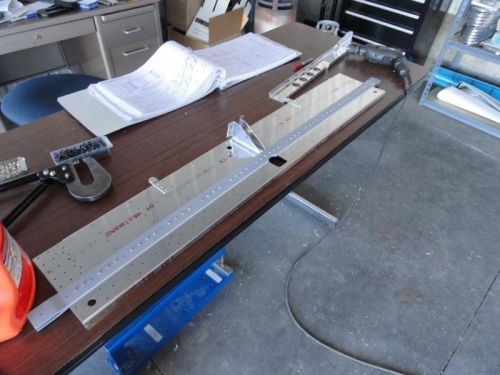

Brief Description:  Assembled rear spar bulkhead
Clecoed and match-drilled all part. Cleaned up edges on the spar carry-throughs and deburred them, then primed them. While waiting for the primer to dry, cleaned up the remaining parts and countersunk for nutplates and the rivets on the bulkhead sides. Riveted the carry-throughs to the bulkhead, then riveted remaining parts and finally clecoed the sides on per the instructions.
