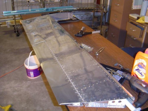

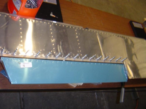

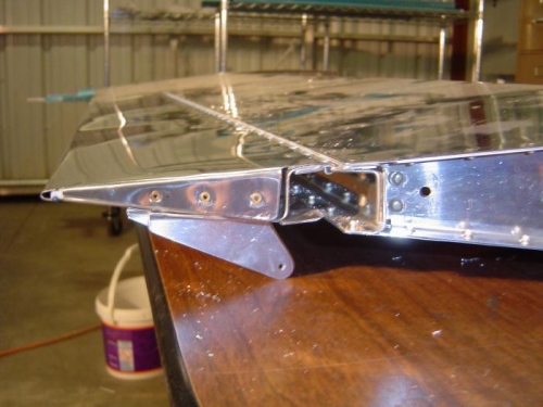

Brief Description:  Attach trim tabs to elevators
Cut two pieces of hinge and drilled the initial holes. Then dtrilled the hinges to the elevators (tip: don't keep the hinges flat; rotate them so the flanges are at an angle to stiffen and straighten the hinge for drilling). Trimmed the hinge to fit the trailing edge and then riveted it. Checked that the trim tabs ribs had set and then set the pulled rivets at the ends. Drilled the trim tabs to the hinges in the same manner as the hinges were drilled to the trailing edge. Trimmed the hinge to match the trim tab and then riveted the hinge to the tab. Bent the hinge pin in the manner shown and drilled the 1/16" hole for the safety wire but did not safety the hinge yet. Repeated all steps for both tabs
