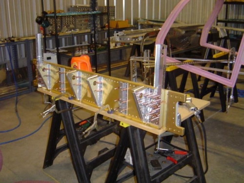

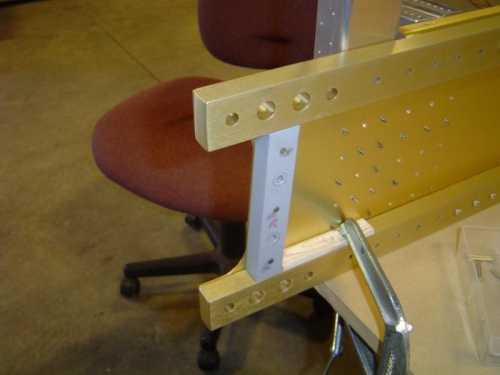

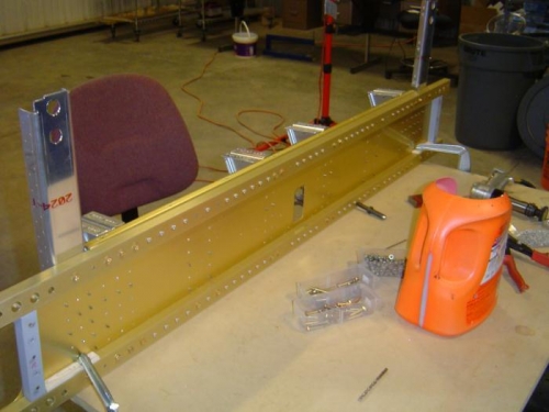

Brief Description:  Assemble aft wing carrythrough bulkhead
Finished polishing edges on set rails and riveted the pairs together, then clecoed into place on the spar carrythrough, along with the bulkhead sides and hat stiffeners. Primed the J sections and temporarily bolted them in place with AN4 bolts, then riveted in place. Added the AN3-12 and AN3-13 bolts, washers, and nuts.
Rivet count: 66 Total: 3990
