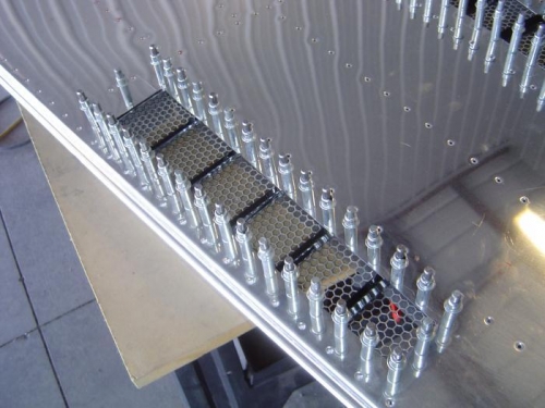

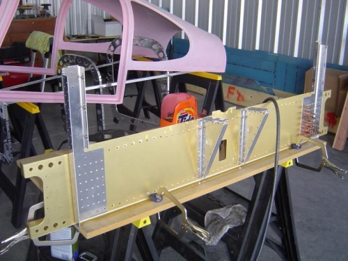

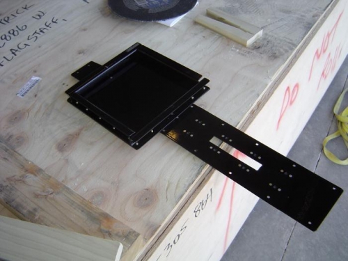

Brief Description:  Bulkhead riveting; other assembly
Riveted bulkhead parts to forward wing spar bulkhead. Received powder coated parts and assembled and riveted the battery holder together. 1/4" bolts in the proper length were not available so I took the long bolts and cut them down and the cut threads on the raw shank. Dimpled the bottom skin for the louvers and trimmed the screen to size and to fit over the rivets. Clecoed the louvers to the skin, followed by the screen and then the inlet/outlet box. With everything clecoed tightly in place, I mixed up 3 oz. of ProSeal and sealed the joint around the screen/louver/skin.
