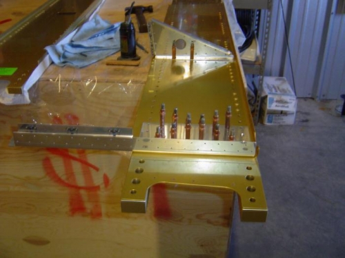

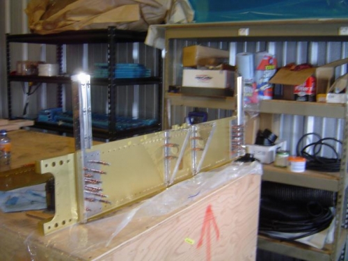

Brief Description:  Assembly of forward center spar carrythrough
Countersunk and deburred parts. Riveted the seat support halves together and then added the nutplates to them and the center section bulkheads. Clecoed all parts to the center section and added the bolts/screws.
