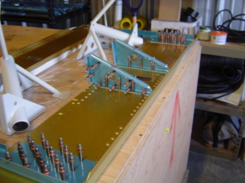

Number of Hours:  1.50
Manual Reference:  25-1.1 to 25-2.3
Brief Description:  Forward spar fabrication

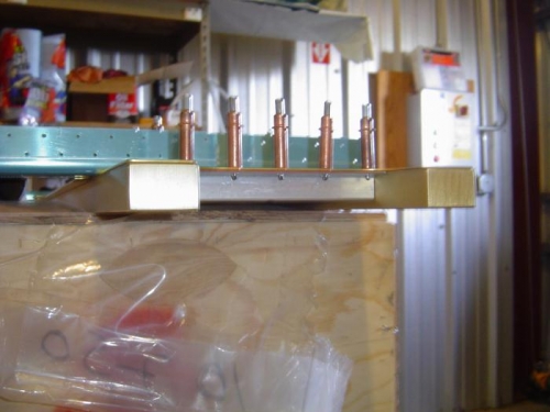

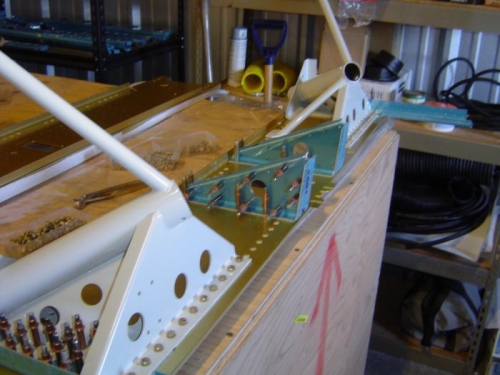

Fabricated end stiffeners for the spar and drilled/clecoed into place. Assembled mid-spar seat supports and match drilled. Similarly, drilled and clecoed both end pieces to the spar. Drilled the #12 holes in all the parts and then bolted the gear weldments to the spar in preparation for drilling the lower holes next time.
