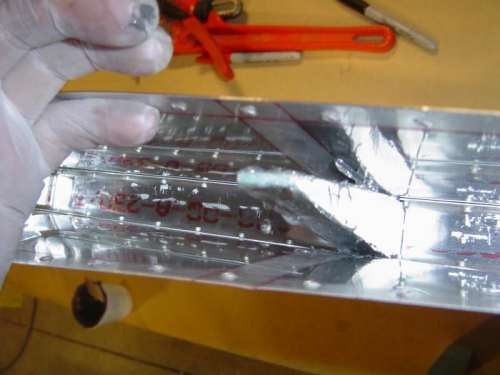

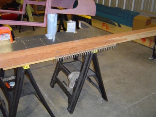

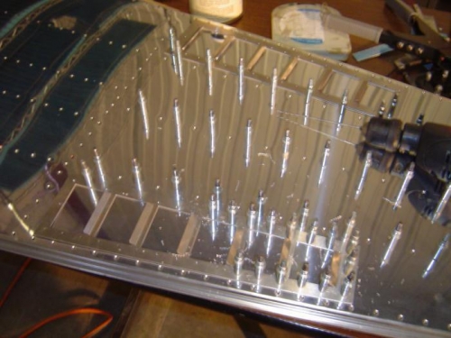

Finished the leading edge on the left elevator. Cut the ribs for the right elevator trailing edge and cleaned all the parts. Mixed two ounces of proseal and applied to foam ribs before inserting them in place. Applied proseal to the trailing edge wedge and clecoed it in place between the elevator skins. Placed elevator on a flat surface and placed wooden beam on trailing edge to weight it down while the proseal cures.
