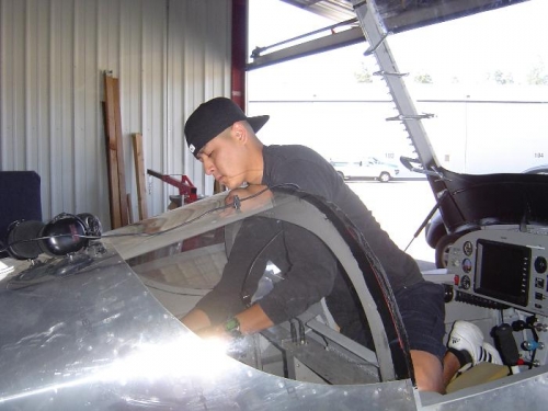

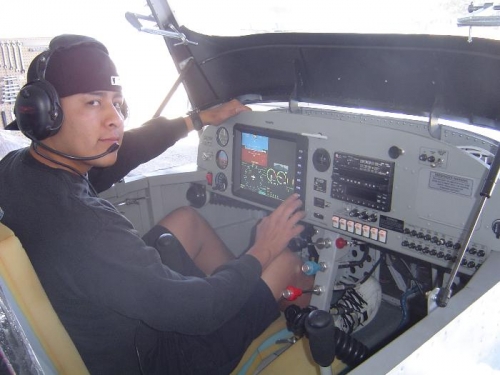

With help from Myron James the hinge bolts for both elevators and the rudder were tightened and torque-sealed. Also the pushrod for the elevator control - I verified the jam nuts were tight and torque-sealed them. Next we installed the seat belts with drilled bolts, castellated nuts and cotter pins. Finally, we finished marking the panel controls: canopy jettison, cabin heat, alternate air, fuel purge, prop, throttle, mixture, and trim.
