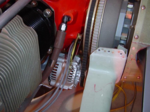

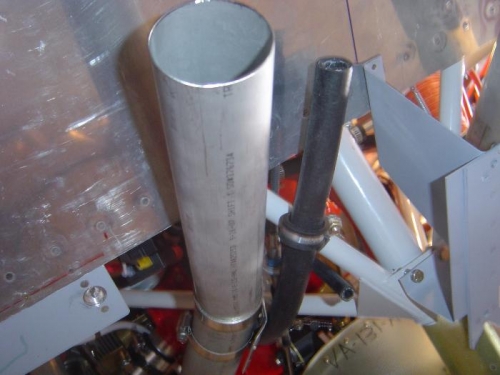

Brief Description:  Breather and fuel vent lines, saftey alternator
Fabricated and routed the crankcase breather line and vent line for the mechanical fuel pump. Clamped both lines to prevent movement. Checked the alternator tension adjustment and saftied the bolts on the bracket.
