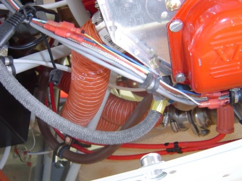

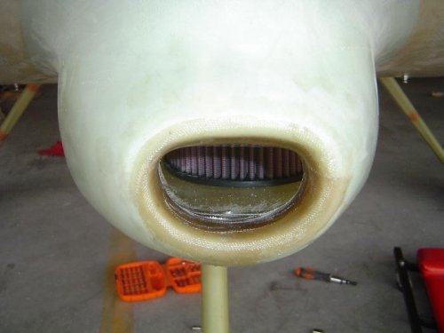

Routed right side EGTs after crimping connectors to wire. Color coded: Blue/White = #1, Red/White = #2. Cleaned up and clamped other connections in area. Trimmed layup for FAB connector to length. Fitted gasket material to airbox and installed airbox on engine with filter. Test fit cowling to airbox.

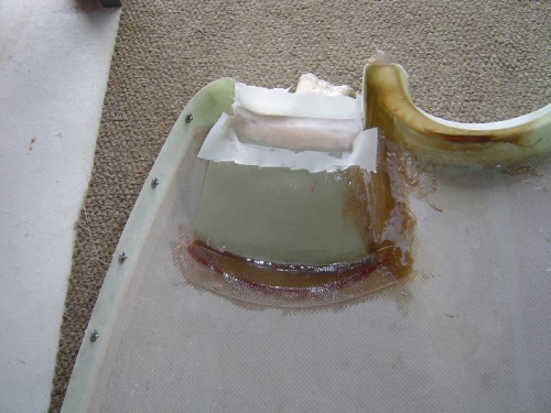

Back at Jack Keegan's hangar, laid up reinforcing strips for the upper cowl inlet ramps. Also laid up backing for the spinner area so it can be sanded to fit behind spinner with proper clearance.
