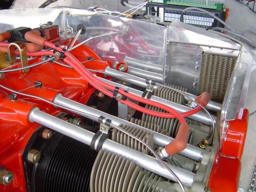

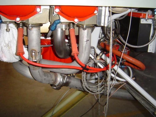

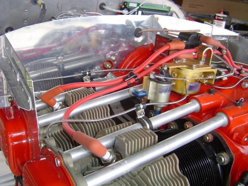

Finished fabricating the spark plug wires for the lower left side; straight connector at plug and 90 degree at coil. Used spacers and clamped to engine mount to finalize mounting. Utilized supplied wires for the upper left set; fabricated a couple of tabs to fix the routing over the cylinders with spacers. One tab simply spaces the wires and fuel purge cable from each other. Used one supplied wire and fabricated one for the upper right side; positioned a space to be held to the fuel purge line with a clamp when it is installed.
