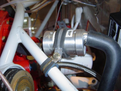

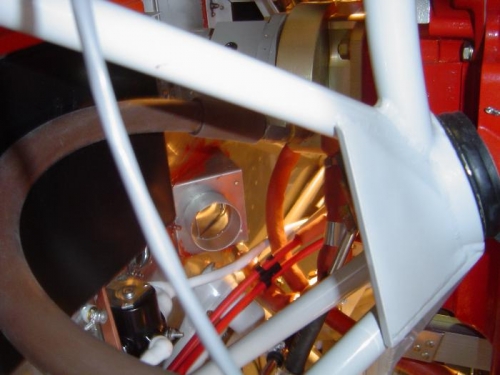

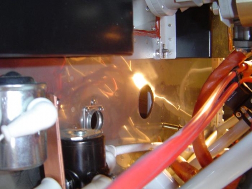

Brief Description:  Cabin heat box and breather seperator install
With help from Jack Keegan, used a punch set to make hole in firewall for cabin heat selector box. Installed box with high-temp RTV and modified control arm to clear firewall structure and take bowden cable fitting. Installed breather and flexible line to engine, secured with adel clamps.
