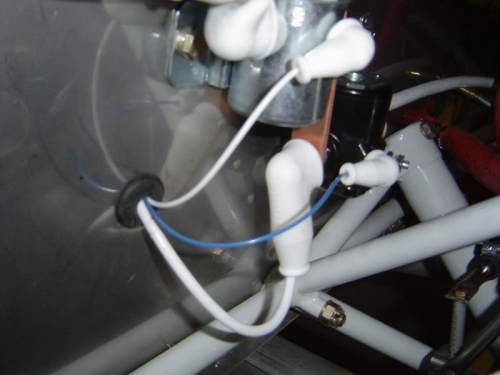

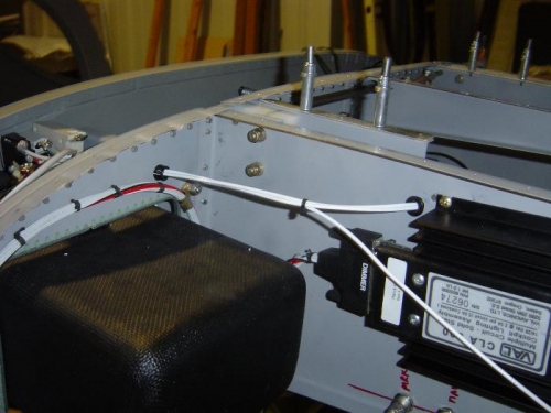

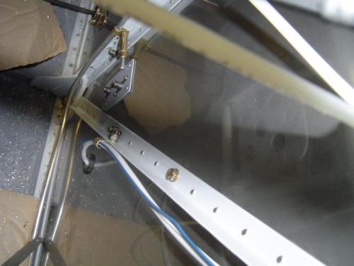

Brief Description:  Ignition and solenoid wiring
Installed adel clamps for the dimmer bundle. Routed the ignition key wires to the lightspeed boxes pending soldering to connector. Routed the main battery cable through the opening with the right side coax. Routed the main buss and solenoid cables through the firewall and up a stiffener using adel clamps; continued the buss wire to the buss breaker.
