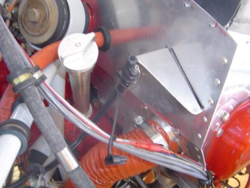

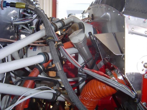

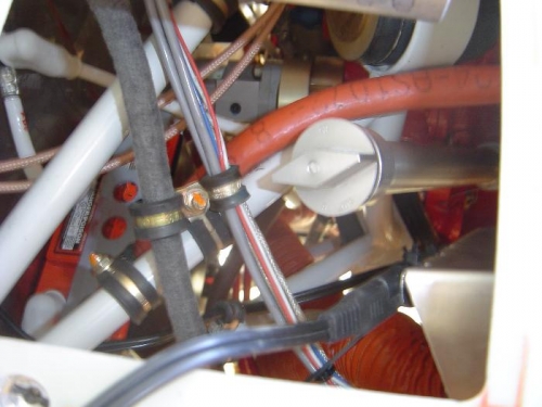

Brief Description:  Fabricated bracket for charger connection
Fabricated an aluminum bracket to attach to the back of the engine baffling to position the battery charger connection so it can be reached through the oil filler door. It was then pop-riveted to the baffle and the charger connection tie-wrapped to it. The connection was ground checked and the bracket does an excellent job of holding the connection so that the charger or the cover can be attached easily through the oil filler door. It will be checked over the next few flights to be sure that the wire does not chafe or move due to engine movement.
