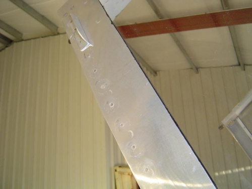

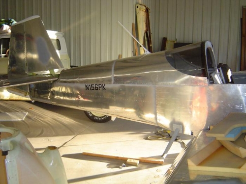

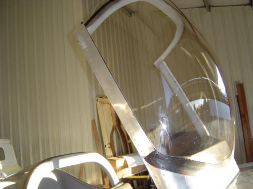

Brief Description:  Apply markings, canopy side strips, repair rt. bra
Applied vinyl registration numbers to fuselage side. Fabricated canopy lifting handles and drilled to side strips. Countersunk side strips and handles and riveted them in place. Removed leaking fitting from right brake and reinstalled with nylon tape, then bled and tested brakes.
