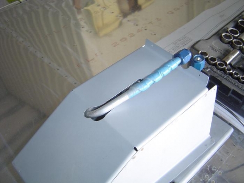

Brief Description:  Fuel Pump cover, pitot static check
Removed fuel pump assembly from fuselage to facilitate cleaning up the floor and also adding the pump cover. The return line interferes with the cover likely because the valve is positioned per the plans for a -6A while the pump and cover are intended for a -7/9. Since the cover is compromised as a sound barrier due to lack of floor in front of it and panel behind it, I decided to simple cut an access through the top, keeping it as small as possible. At a later time I can add some rubber strip leftover from the wing root to seal the opening. I cut the access right at the 'corner' where the cover slopes downward and then made keyhole slots to allow the cover to be positioned properly and also moved back so the return fitting could be tightened.
