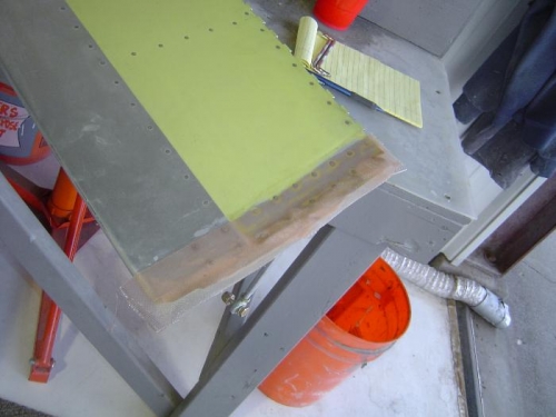

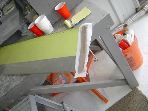

Brief Description:  Right flap repair, brake fluid added
Laid up a strip of glass tape to the inboard end of the right flap to cover uneven joggle and fill excessive fuselage/flap gap.
