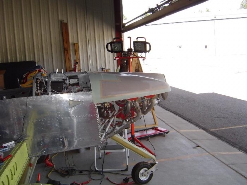

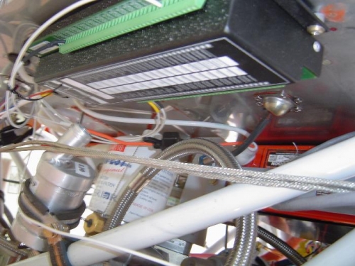

Brief Description:  Pressure sender location, initial cowl fitting
Finalized routing for pressure sender lines and ordered parts for oil pressure "T" to hobbs switch. Installed fuse holder and fuse for EFIS keep alive circuit and also installed left ignition to backup battery. Trimmed baffling enough to do initial location of upper cowling so that clearances inside could be determined.
