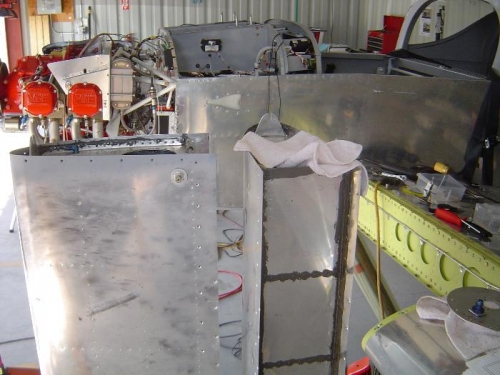

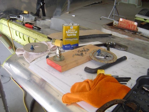

Brief Description:  Removed wing tanks and fuel senders
Blue Mountain Avionics informed me that the fuel senders would not work accurately with the EFIS/Engine Pod if their return was via aircraft ground. Instead, the senders would have to be electrically isolated. In preparation for this, I removed both wing tanks and took off the end plates and senders. After cleaning the fuel lube from the sender plates and end plates, I decided to order new gaskets from Vans as well a shoulder washers to isolate the senders.
