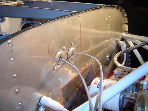

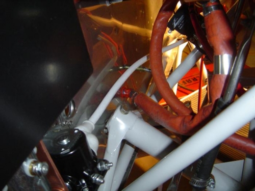

Brief Description:  Firewall penetrations for ignition and fuel

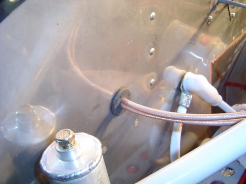

Made firewall penetration for fuel line with 45 degree bulkhead fitting. Fabricated aluminum washer and installed with hi-temp RTV. Made the firewall penetrations for the ignition wires. Slotted the penetrations for the sensor wires to allow the connector to pass and installed the nutplates for the shields. Final installation will be done with RTV to seal. Installed the coax grommet but not the shields for the right side.
