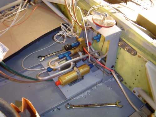

Borrowed tubing benders and fabricated line from filter to fuel pump. Installed assembly in aircraft to facilitate plumbing remaining lines. Installed T fitting in fuel selector. Removed pointer from aft side of selector handle so handle itself will be the pointer.

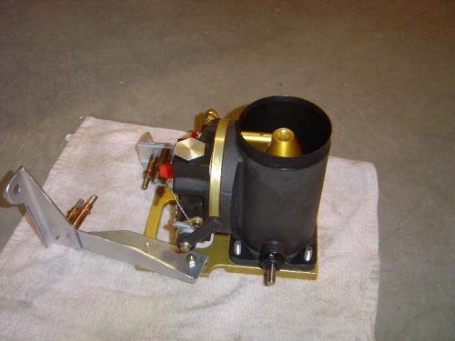

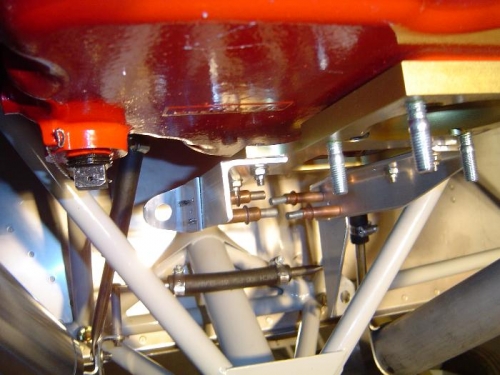

Completed fabrication of the throttle and mixture cable brackets. Took pictures of brackets with the throttle body and attached to the sump so they could be posted on my wiki for use by Airflow Performance and other RV builders.
fuel pump plumbing in progress
mixture bracket w/throttle body
brackets on sump
brackets on sump
