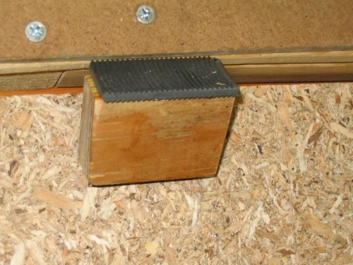

Brief Description: made new edge breaking file for skins
John Marshall showed us a better file to use for breaking edges. This along with a V-notch edge deburr tool and a 3" scotch brite type (Norton abrasives) wheel in the drill press prepare well rounded edges that are much better at holding paint. We just bought a 10" Vixen file from Cleveland. It is beautiful, German made, and very sharp. So.......given the thought of a much easier file, we promptly cut 3" off the end with a cut off tool(wow, that hardened tool steel is something!)and glued it to a wood block with JB Weld. Tried 2 ton epoxy first which promptly broke.Also primed all HS and VS parts over two nights. Ready to assemble
