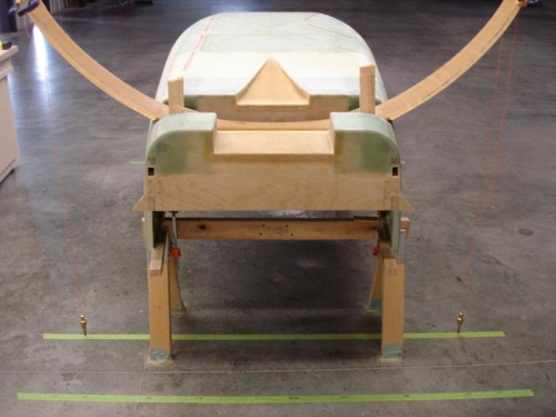

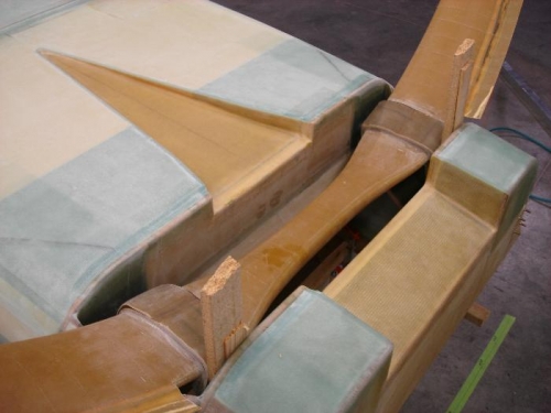

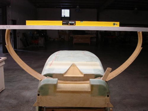

The fuselage has been leveled For & Aft, left & right and the gear leg is level and centered on the fuselage using the 1/4" aligning rods. You can see the green tape on the ground used for findng the correct FS locations and the plumb bobs hanging from the gear legs.
Gear legs level
Gear legs level

Centered in Fuselage
