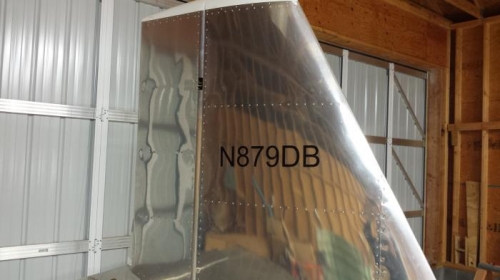

The second step that N numbers are 12 inches are NA since aircraft is E-LSA, not S-LSA). Three inch N numbers are used on the vertical stabilizer on each side.

N Number
N Number
