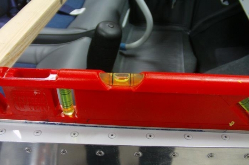

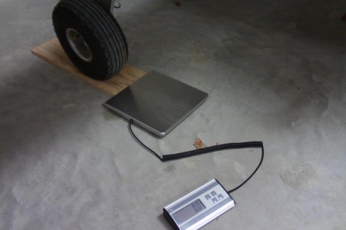

Following procedure in the RV-12 Maintenance Manual, measured/calculated the arms and weighed the airplane. A couple of specifics:
- Used three ACE200 Smart Weigh scales
- Leveled canopy deck (laterally and longitudinally) by adjusting tire pressures.
- Full interior, POH, fuel tester, pitot cover, and tow bar in airplane during weighing.
- Canopy closed during weighing.
- Weighed three times by rotating scales to different wheels after each weighing. All three weights for each wheel were within a couple pounds of each other so averaged the three weights for each wheel and used that for weights.
- LH wheel = 297 pounds; RH wheel = 305 pounds; nose wheel = 147 pounds. Total weight = 749 pounds.
- Calculated empty center of gravity and came out to 81.19 inches.
- Calculated most forward and most aft loading to verify airplanes stays within center of gravity range - which it did.

Canopy Deck Level
Canopy Deck Level
Setup Ready to Weigh
Detail of Setup
Detail of Setup
