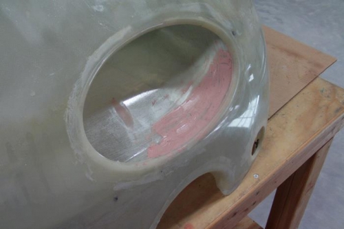

Had very small gaps at front oval opening of bottom cowl so filled with Bondo. Sanded/refilled, as necessary for smooth blend. (step 10)
Filled cleco holes with flox epoxy mixture and ensured drain holes are still open. (step 11)

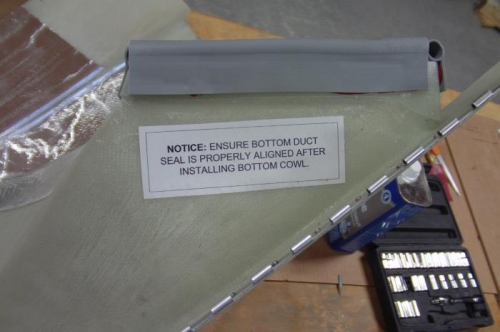

Copied and printed label on page 49-21, glued to cowl duct, and brush coated with epoxy resin. (step 12)
PAGE 49-14 & 49-21 ARE COMPLETE

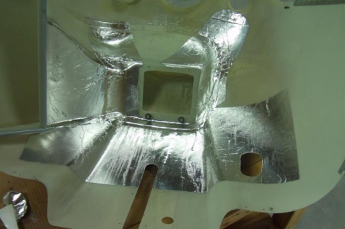

Page 49-16
Received more heat shield from Van's. Used mis-cut bottom shield as a template and cut new bottom piece. Installed and rubbed into place. (step 4 - complete)
Sealed edges of heat shield with epoxy resin. (step 5)
PAGE 49-16 IS COMPLETE

Heat Shield
Heat Shield
Duct Label - Prior to Coat of Epoxy
Bottom Cowl Oval Opening
