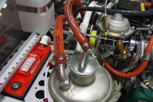

Date:  10-13-2016
Number of Hours:  1.60
Manual Reference:  49-17 & 49-18
Brief Description:  Installed Oil Hoses
Installed hose bracket over lower nut on cylinder #1 exhaust pipe. (step 1)
Install oil supply hose between oil tank and oil cooler. Finger-tightened hose at oil cooler. (step 2)
Installed oil cooler hose between oil cooler and oil pump. Finger-tightened hose at oil cooler. Secured oil hose to hose bracket with cushioned clamp. Although not specifically called out, installed an AN960-10L washer between clamp nut and hose bracket so nut did not bear down on power coat of bracket. (steps 3 and 4)
Installed oil return hose between oil tank and oil return nipple on bottom of engine. (step 5)
Did an initial fit of the bottom cowling but was unable to get the oil cooler to drop into the cowl guides. The oil cooler sits higher on the right side and the left side is just short of reaching the cowl guides. Need to adjust hose routing and get an extra hand to help with the installing the bottom cowl.
Hoses at Oil Tank
Hoses at Oil Tank

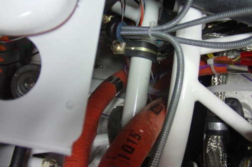

Hoses at Oil Cooler & Return Nipple
Hoses at Engine Stand Off & Mount
