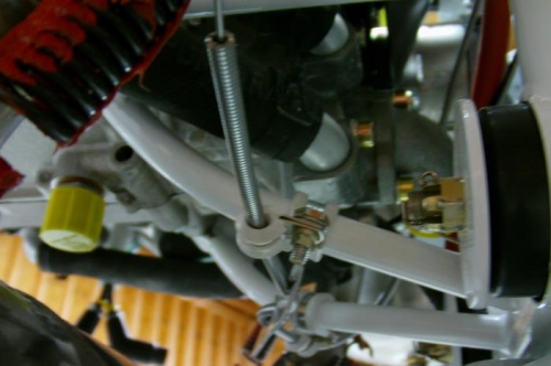

Installed three sets of double clamps to engine mount ring. What a PITA! The upper right set of clamps was especially difficult because of lack of easy access. (step 1)
Installed friction comb. (step 2)
Pulled cable out of the sheath and trimmed end of cable sheath. Tried to reinstall the cable and but it was hanging up in the sheath at the lower right clamp area. Had Denise wiggle the sheath in that area and was able to get the cable reinstalled. Would have been much easier to do this task prior to installing the exhaust. (steps 3 and 4)
PAGE 49-09 IS COMPLETE

Cable Clamps & Trimmed Sheath End
