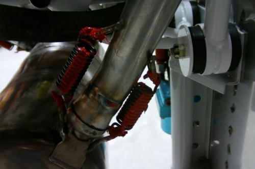

RTV'd Exhaust Springs
Removed springs, one at a time, filled with red RTV, and reinstalled. As an added piece of mind, added a bead of sealant on opposite sides of outside of spring. Added RTV over spring ends. (step 2)
PAGE 48-06 IS COMPLETE
SECTION 48 IS COMPLETE
Right Side Springs

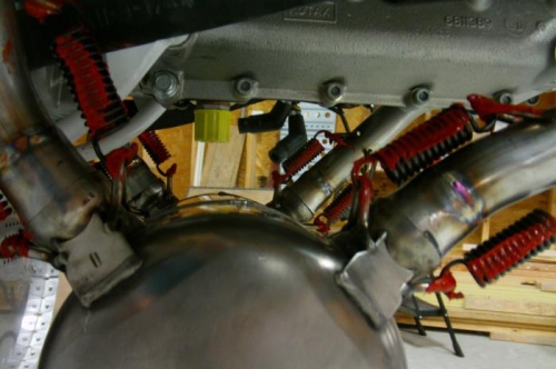

Springs at Cylinder #2

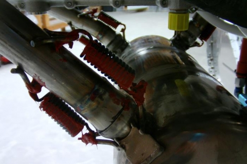

Springs at Cylinder #4
