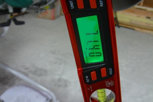

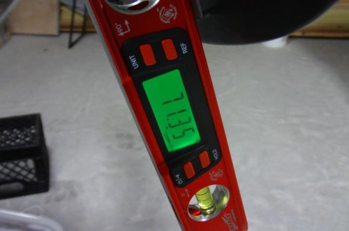

Using wood blocks and level, rotated propeller so blades were horizontally level. (steps 1 through 3)

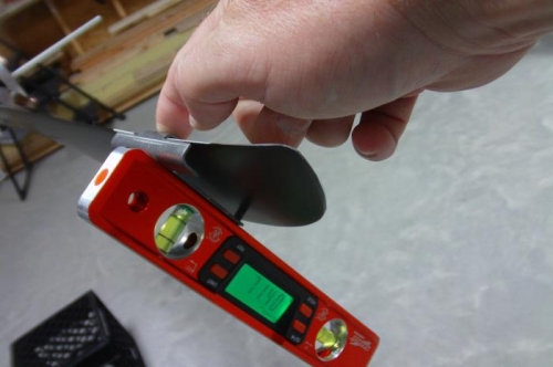

Set digital level relative angle to 0 degrees at the canopy deck, then installed prop pitch bracket and level on backside of right prop blade. After many iterations, got blade adjusted within specs. Rotated propeller 180 degress and repeated for the other prop blade. (steps 4 through 6)
Final torqued propeller bolts by step torquing bolts in a crisscross pattern to 120-175-235 inch pounds. Final measured angles on torqued propeller are 71.35 degrees and 71.40 degrees. Within specification tolerances of 71.4 +/- 0.1 degrees and within 0.2 degrees of each other. (step 7)

Level on Prop Pitch Tool
Final Value on One Blade
Final Value on Other Blade
