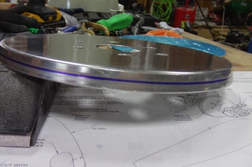

Drew centerline on flange of spinner plate. Accomplished by mounting to side of Scotch Brite wheel on arbor of grinder. While holding Sharpie, rotated spinner plate to draw line. (step 5)

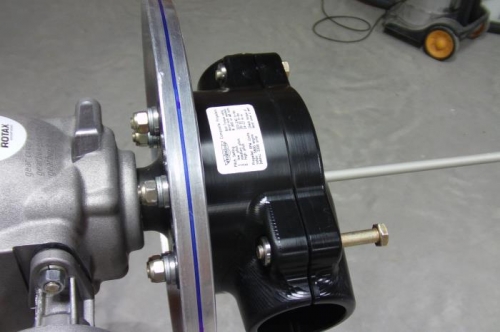

While mounting spinner plate and hub mount half to engine flange, noticed anomaly in bolts. It appears that half of the bolts are too long to mount the other half of the hub. Email out to Van's to resolve.

Centerline on Spinner Plate
Bolts Too Long for Hub
