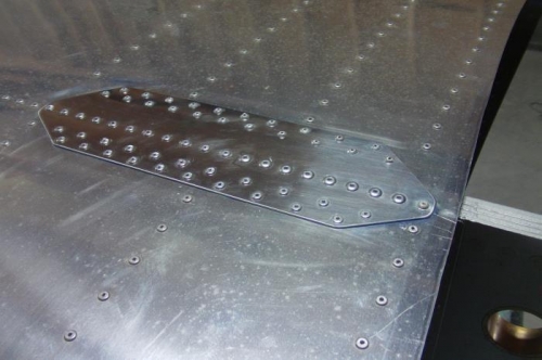

Date:  8-4-2016
Number of Hours:  1.90
Manual Reference:  SB 14-11-03
Brief Description:  Complete SB 14-11-03 - RH Wing
Completed this Service Bulletin for the RH wing using identical steps as done for the LH wing. The only difference was no requirement to use a piece of steel to protect spar cap while match drilling.
See entry for this SB on 8/3/2016 for details.
SERVICE BULLETIN 14-11-03 IS COMPLETE FOR RH WING.
SERVICE BULLETIN 14-11-03 IS COMPLETE IN IT'S ENTIRETY.

Doubler Installed
Doubler Installed
